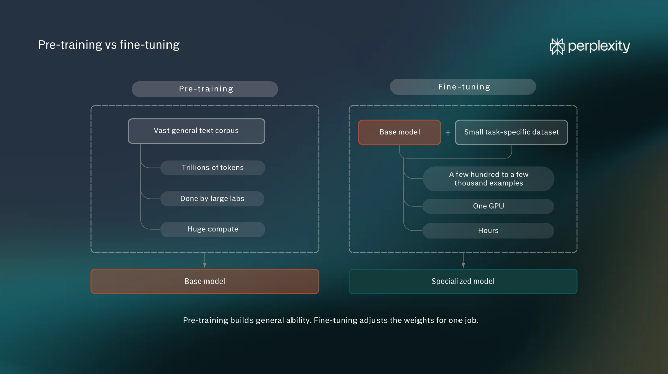

Diagram comparing pre-training and fine-tuning: pre-training turns a vast general text corpus (trillions of tokens, large labs, huge compute) into a base model, while fine-tuning combines a base model with a small task-specific dataset (a few hundred to a few thousand examples, one GPU, hours) to produce a specialized model.

What's LLM fine-tuning and how it's different from LLM pre-training
LLM pre-training builds a model’s general language ability from scratch on a vast corpus, while LLM fine-tuning adjusts a pre-trained model on a small dataset for one job.
LLM pre-training is the resource-heavy phase that produces a base model. It learns from a broad text corpus, which gives it general grammar, facts, and reasoning but no specialization for your task.
LLM fine-tuning continues base model training on a small, curated dataset so it produces the desired outputs for a specific task or use case. Think of a consistent format, a brand voice or tone, domain-specific patterns, or reliable tool and function calls.

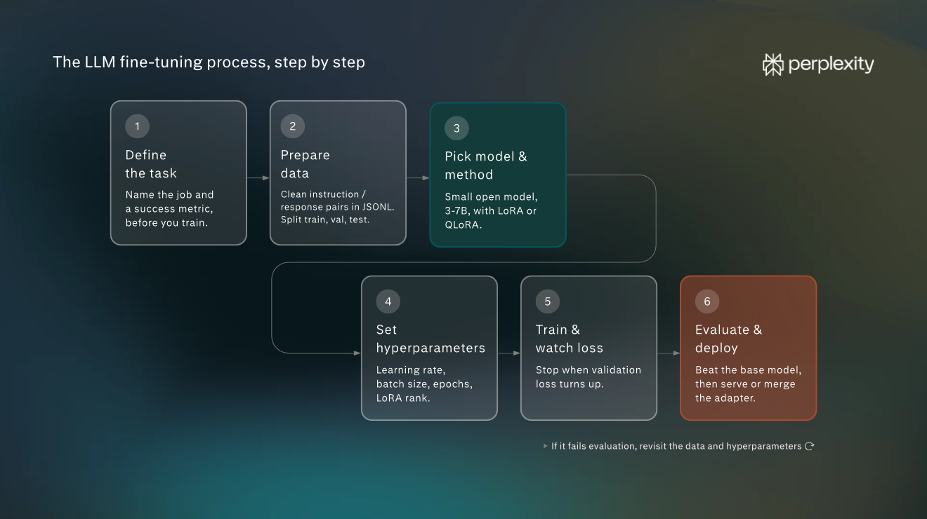

How to fine-tune an LLM step by step
Once you’ve decided fine-tuning an LLM is the right call, here’s the workflow.
Step 1: Define the task and how you’ll measure success
Decide what behavior you want from the LLM and how you’ll know you got it.
Name the specific job you want the fine-tuned model to complete, for example, classifying support tickets, summarizing contracts in a fixed format, or generating code in your house style.
Then define success. Common options include:
  • Output validity: For example, does the result parse as valid JSON or match the Markdown structure you need?
  • Automated scores: Use metrics like BLEU or ROUGE that compare generated text against reference answers, or task accuracy on a labeled set.
  • Human ratings: A scored or pass/fail rubric for qualities a script scores poorly, like tone or helpfulness.
  • Reliability on hard inputs: Does it handle the unusual inputs that tripped the base model?
Step 2: Prepare your dataset
Data quality determines the success of the fine-tune, so put effort into collecting the right fine-tuning dataset.
Format your data as instruction/response pairs, in JSONL, where each line holds the input (plus any context) and the exact output you want back.
For example, check out public datasets like the general-instruction Alpaca-cleaned dataset or Databricks' Dolly, or the task-specific banking77, which includes over 13,000 real support queries labeled across 77 intents.
For a focused task, a few hundred to a few thousand clean, varied examples can shift behavior. As long as the examples mirror real production inputs, including the edge cases, and are consistently formatted.
No input/output pairs yet? Build the set from the data you already have, like support tickets and their best replies, or documents and their summaries.
If you only have the outputs, use a stronger model to generate a plausible input for each, or hand-write a small seed set and expand it with a larger "teacher" model, then keep the best pairs.
Finish by splitting the data into training, validation, and test sets, so you can measure on examples the model hasn't seen.
Step 3: Pick a base model and method
Start with a small open-source model of 3 to 7 billion parameters and a parameter-efficient fine-tuning method like LoRA or QLoRA.
Open families like Llama, Mistral, and Qwen give you a strong base you can host yourself, and the PEFT methods keep the hardware bar low: QLoRA quantizes the base to 4-bit, so fine-tuning a 7B model requires only a 16-24GB consumer card. Full fine-tuning the same model needs many times that memory.
Step 4: Set your training hyperparameters
Here are the key LLM fine-tuning parameters and suggested starting ranges:
  • Learning rate controls how big each update to the weights is. A 2024 study by Biderman et al. found LoRA's best rates sat roughly ten times higher than full fine-tuning's, typically 5e-5 to 5e-4 against 1e-5 to 5e-5. The study advises sweeping from 1e-5 to 5e-4 and using the highest value that trains stably.
  • Batch size is how many examples the model learns from before each weight update. On a single GPU, use a small per-device batch of 1 to 8 and gradient accumulation to reach an effective batch of roughly 16 to 64.
  • Number of epochs is how many times the model sees the full dataset. When training the model to perform specific tasks, 1-3 is a good rule of thumb, but LoRA runs often need more.
  • LoRA rank (r) sets the adapter capacity, or how much it can learn. Start at 8 to 32 for simpler tasks and raise it for harder ones: The Biderman et al. LoRA study cited above, instruction-tuning a 7B model on code needed rank 256 to match full fine-tuning, while rank 64 came close on math.
  • Maximum sequence length is the longest input the run will process. Set it to cover your longest examples, up to the model's context window, as anything longer gets truncated.
  • Warmup and schedule control how the learning rate ramps up and changes across the run. A short warmup and a cosine decay are the usual defaults. However, the Pareja et al. small-model study found dropping warmup didn't hurt final scores.
Treat these as starting points for a sweep, not fixed settings.

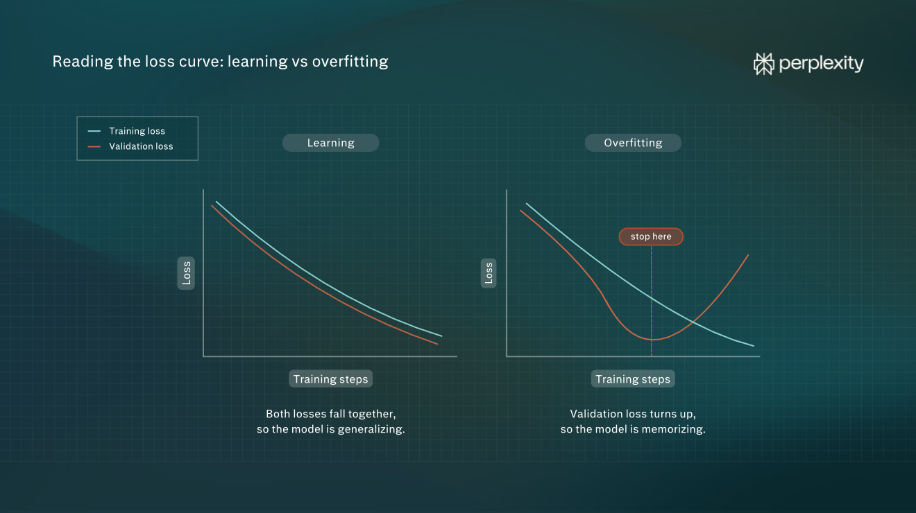

Step 5: Train and monitor loss
As training runs, watch the training and validation loss curves to see if it's working.
Loss measures how far the model’s outputs are from your examples, and it should fall smoothly as the run proceeds. Training loss covers the data it learns from. Validation loss is on the held-out examples.
If training loss and validation loss fall together, the model is learning to generalize. If training loss keeps dropping but the validation loss flattens or climbs, the model is memorizing the training set instead of learning the pattern (overfitting).
Step 6: Evaluate, then deploy
A low training loss doesn’t guarantee correct outputs, so assess the fine-tuned model on the criteria you set in Step 1.
When it passes, you have two ways to deploy:
  • Serve the adapter on top of the base model and load both at runtime; this keeps the adapter swappable.
  • Merge the adapter into the base weights to get a single standalone model that’s simpler to host.
