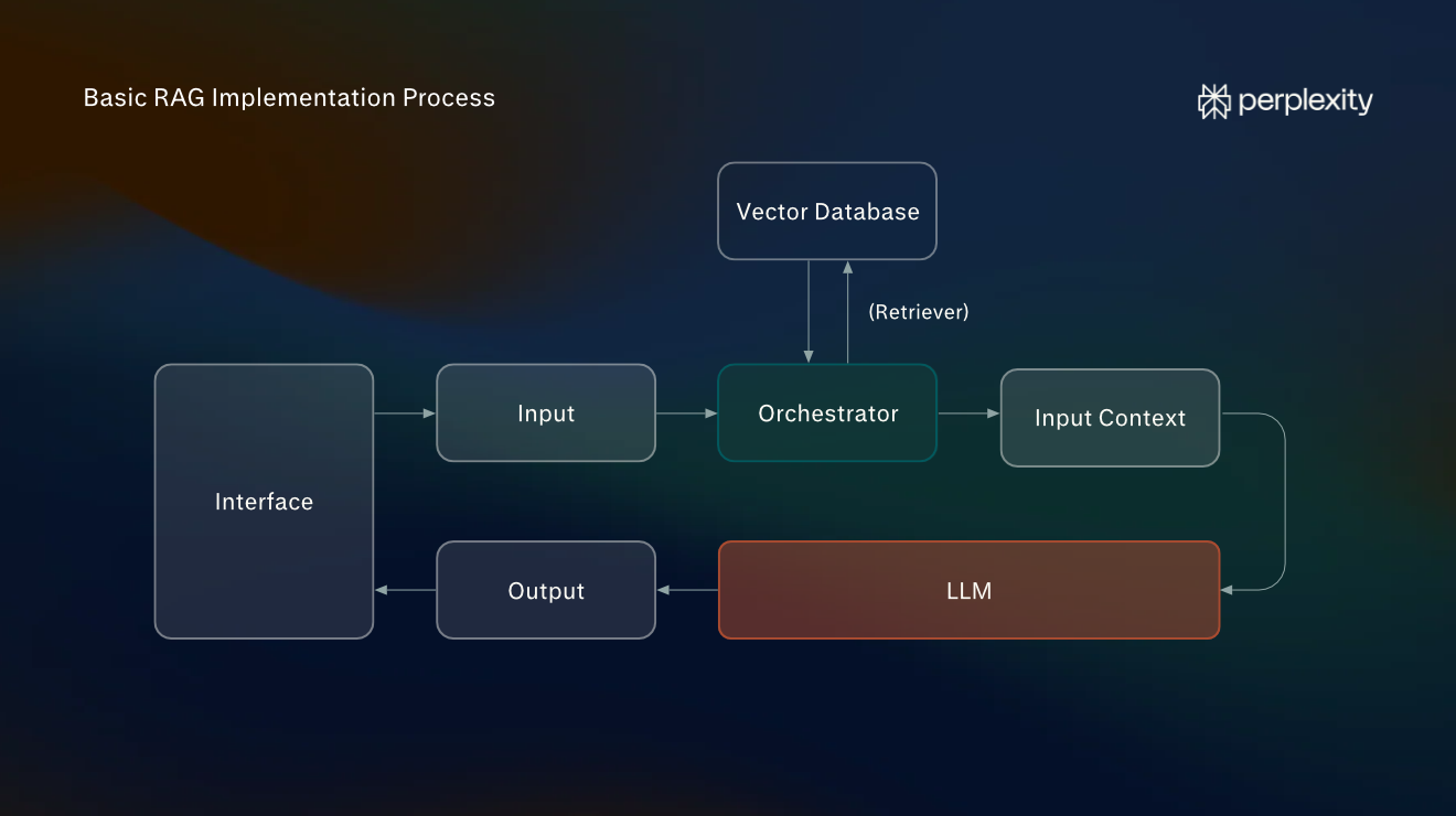

Basic RAG implementation process diagram: the interface sends input to the orchestrator, which retrieves data from a vector database, builds the input context for the LLM, and returns the output to the interface.

Basic RAG implementation process: A high-level overview
A basic RAG system has three main components: an orchestrator, an information source, and an LLM. In a typical workflow, a user enters a prompt, and the orchestrator modifies it to search any connected information sources. The retrieved information is then added to the original input context and sent to the LLM so a reply can be generated.
You will need to account for these steps when building your RAG implementation:
  1. Indexing and embedding: In this stage, your documents are converted into an information source that the orchestrator can search. One of the most common ways of doing this is to build a searchable vector index. We’ll use a dedicated model from Perplexity to convert your document chunks into embeddings. We’ll then store the embeddings with ChromaDB, a popular open-source vector database.
  2. Orchestration: This is the application that sits between the external information source (a vector database in our case) and the LLM. We’ll create a simple Python script to act as the orchestrator.
  3. Retrieval and generation: When a user asks a question via the chat interface, the orchestrator will take it, run a vector search, and feed the expanded input to the LLM. We’ll use the command line to prompt to communicate with our Python orchestrator rather than build a dedicated frontend.

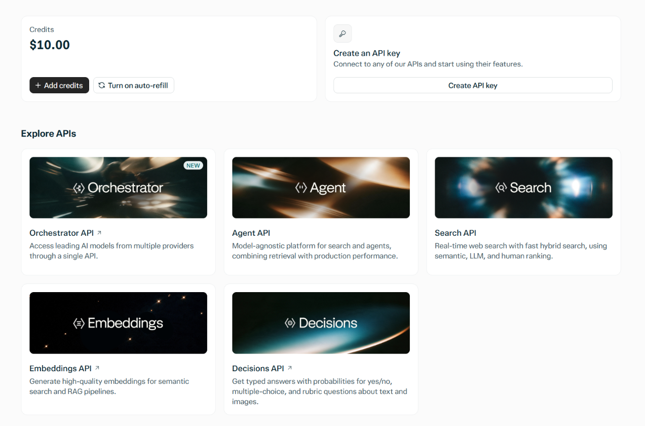

Replace your_api_key_here with your actual key. To do this, you’ll need to head to the Perplexity API Console home dashboard and select Create an API key. Keep this API key private.
We’ll be using two models: Perplexity’s pplx-embed-v1-0.6b to embed our documentation before uploading to ChromaDB and GPT-5.6-Luna (accessed through Perplexity’s API), which will process the retrieved information.
