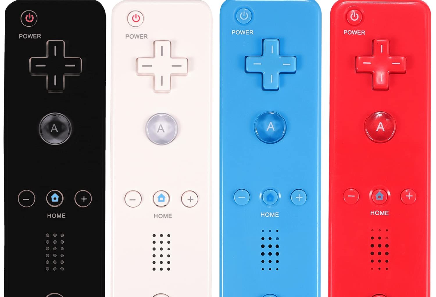

Battery-related issues are the most common cause of a Wii Remote not turning on. Here are the key points to consider when troubleshooting battery problems:
  • Replace the batteries with a fresh set of high-quality alkaline batteries.1
  • Ensure the batteries are inserted correctly, following the polarity indicators in the battery compartment.2
  • Check for battery leakage or corrosion on the battery contacts, which can prevent proper power flow.34
  • Clean the battery contacts using isopropyl alcohol and a cotton swab if there are signs of corrosion.4
  • If using rechargeable batteries, make sure they are fully charged before use.2
  • Try multiple sets of new batteries to rule out a faulty batch.5
  • Verify that the battery cover is securely closed, as loose connections can interrupt power.2
If these steps do not resolve the issue, the problem may lie with the Wii Remote's internal components or other factors.2

Syncing problems can prevent a Wii Remote from turning on or functioning properly. Here are some steps to troubleshoot and resolve syncing issues:
  • Clear all syncs from the Wii console and reset the Wii Remote1
  • Resync the Wii Remote with the Wii console1
  • Ensure the Wii Remote is being used between 3 and 10 feet directly in front of the TV1
  • Verify that there are no bright light sources or infrared light near the TV or gameplay area1
  • Check for interference from other wireless devices nearby2
  • Try a cold reboot of the Wii console by unplugging it for 15-20 seconds2
  • If possible, test the Wii Remote with another Wii console to isolate the problem2
  • Ensure you are using a licensed Wii Remote (model number RVL 003 or RVL 036)1
If these steps do not resolve the syncing issue, there may be a problem with the Wii Remote's Bluetooth transmitter or the console's receiver, which may require professional repair or replacement2.

A malfunctioning power button or internal components can prevent a Wii Remote from turning on. The connection between the power button and the motherboard may be dirty or damaged, causing the remote to remain unresponsive1. To address this, try cleaning the power button contact by gently brushing it with a new, dry toothbrush after opening the cover plate1. If cleaning doesn't resolve the issue, the power button may be misaligned or the connection could be damaged, requiring replacement1. In some cases, a faulty motherboard might be the culprit, especially if all other troubleshooting steps have been exhausted1. For persistent issues, professional repair or replacement of the Wii Remote may be necessary2.

A poor power button connection can prevent a Wii Remote from turning on. This issue can be caused by dirt, misalignment, or damage to the power button or its connection to the motherboard. Here's a summary of the problem and potential solutions:
ProblemSolution
Dirty power button contactClean the contact with a dry toothbrush after opening the remote 1
Misaligned power buttonCarefully realign the power button using a guide 1
Damaged power button connectionReplace the power button using a replacement guide 1
Faulty motherboardConsider replacing the motherboard if other solutions fail 1
If cleaning and realignment don't resolve the issue, the power button or motherboard may need replacement. For complex repairs, professional service might be necessary. Remember to handle the Wii Remote carefully when attempting any internal fixes to avoid causing additional damage2.

Corrosion on the battery contacts is a common issue that can prevent a Wii Remote from turning on. This problem often occurs when batteries are left in the remote for extended periods, especially in humid environments. Corrosion can disrupt the electrical connection between the batteries and the remote's internal components. To address this issue:
  • Remove the batteries and inspect the contacts for any signs of white, green, or blue residue.
  • Clean the corroded contacts using a cotton swab dipped in white vinegar or a mixture of baking soda and water12.
  • For stubborn corrosion, the battery contact plate can be removed and soaked in vinegar for a more thorough cleaning2.
  • After cleaning, ensure the contacts are completely dry before reinserting batteries.
  • If corrosion is severe, it may be necessary to replace the battery contact plate entirely.
Regular maintenance, such as removing batteries when the remote is not in use for long periods, can help prevent corrosion and extend the life of the Wii Remote.

In conclusion, a non-functioning Wii Remote often stems from issues related to its power source and connections. Regular maintenance of battery contacts and terminals can prevent problems caused by corrosion or battery leakage.15 When troubleshooting, check the battery level and consider using high-quality AA batteries or rechargeable batteries.2 Inspect the battery contact solder joints and power button contact for any signs of damage or wear.3 If the power button fails to initiate actual power, it may require cleaning or replacement.4 Proper disposal of battery waste is important for environmental safety. By addressing these common issues, users can often restore their Wii Remote's functionality without the need for professional repair or replacement.

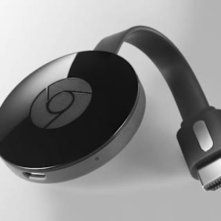

According to reports from The Register, Google's second-generation Chromecast and Chromecast Audio devices are experiencing a major outage due to an expired security certificate, leaving users unable to cast content and prompting the company to warn against factory resets as it works on a fix.
