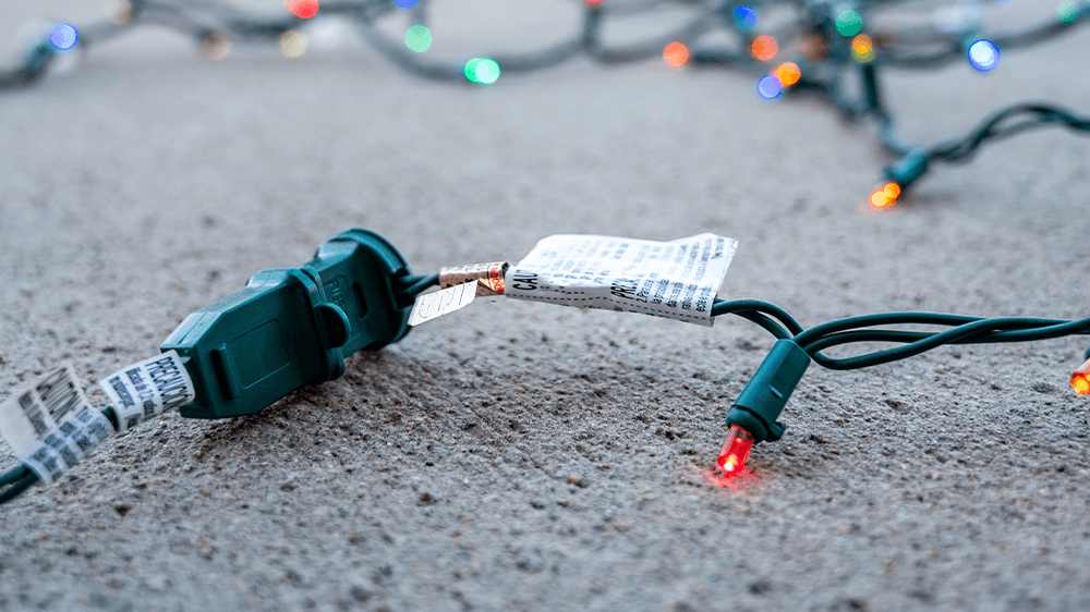

Carefully inspect the entire length of your Christmas light strands for signs of damage, including frayed wires, cuts, or cracks in the wire sheathing. Pay close attention to areas where the lights may have been bent or twisted during storage or installation. According to Angi, if you find any frayed wires, damaged sheathing, or cracked sockets, it's crucial to discard the entire strand and replace it for safety reasons, regardless of whether the lights still work1. This inspection process is essential not only for troubleshooting non-working lights but also for preventing potential fire hazards. Additionally, check for loose connections at the plug and between sections of lights, as these can often be the source of lighting failures.

Testing individual bulbs is a crucial step in diagnosing and fixing Christmas light problems. One effective method is to use a Christmas light tester, which can quickly identify faulty bulbs by detecting voltage changes in the string12. For a manual approach, you can use a working replacement bulb to test each socket by swapping it through the strand, plugging in between changes to check for illumination3. When inspecting bulbs, look for signs of discoloration or missing filaments3. For those without specialized tools, a simple DIY method involves using folded aluminum foil in place of a bulb to complete the circuit - if the lights come on, you've identified the faulty bulb4.

For a more precise diagnosis of Christmas light issues, a multimeter can be an invaluable tool. This device allows you to check for continuity along the entire strand, helping pinpoint the exact location of faulty bulbs or wiring problems. To use a multimeter, place one probe into a hole on the female plug side of the strand and the other on one of the male prongs. If the meter reads infinite, open, or zero, it indicates at least one bad bulb in the strand.1 For a more targeted approach, remove two bulbs several sockets apart and test the section between them. Continue narrowing down the problematic area until you identify the faulty bulb or section. This method is particularly useful for strings wired in series, where a single faulty bulb can affect the entire strand.1 Remember to exercise caution when working with electrical equipment and always unplug the lights before testing.

Once you've identified the problematic areas in your Christmas light strand, the next step is to repair or replace the faulty components. For LED lights, if a single LED is not working, it's often possible to bypass it by soldering a wire across the faulty LED's contacts.1 However, this should only be attempted by those comfortable with electrical work. For incandescent lights, simply replace the burnt-out bulb with a new one of the same voltage rating.2 If you encounter damaged sockets or wiring, it's generally safer and more cost-effective to replace the entire strand rather than attempting repairs. When replacing bulbs, ensure they match the voltage of the original - typically 2.5 volts for strings with multiples of 50 bulbs and 3.5 volts for multiples of 35 bulbs.2 Always unplug the lights before making any repairs or replacements to avoid the risk of electric shock.
