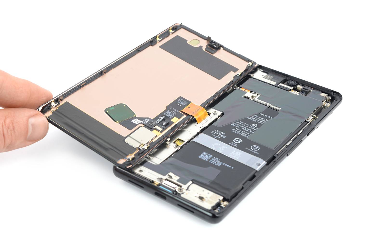

Step #3: Disconnect Display Cable and Remove Screen
After loosening the adhesive and separating the screen from the phone body, the next crucial step is to disconnect the display cable and remove the screen. Here's a concise list of actions to take:
Carefully lift the screen like an open book, keeping it connected to the phone body
Locate the display cable connector on the left side of the device
Use tweezers to remove the metal bracket covering the display cable connector12
Gently disconnect the display flex cable from its socket using a spudger or similar tool12
Carefully remove the screen from the phone body12
If replacing with a new screen, ensure it has the fingerprint sensor attached2
Clean the frame edges thoroughly to prepare for the new screen installation2
Remember to handle the components with care to avoid damaging the delicate connectors or other internal parts during this process.
