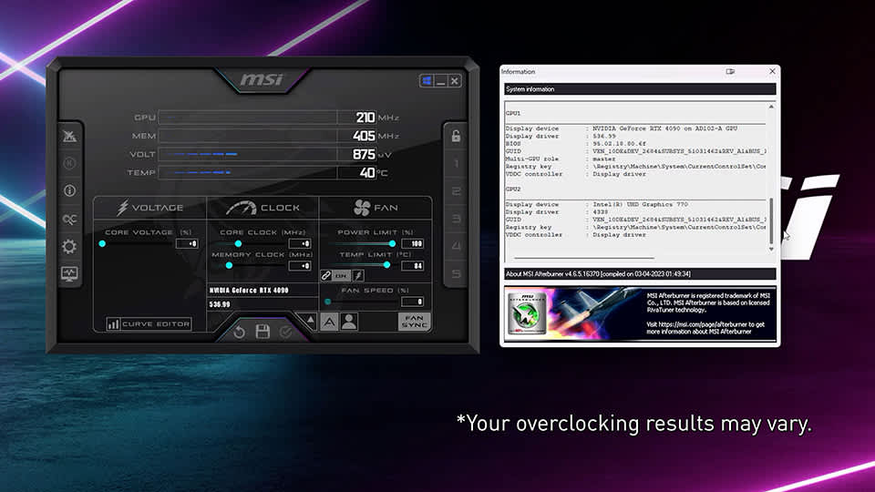

Follow this easy guide to slowly boost your GPU's clock speeds and test how stable it is during overclocking:
  1. Start by launching your favorite overclocking tool, such as MSI Afterburner. This software lets you adjust core frequency, memory speeds, fan speeds, and power limits.
  2. Set the power limit and thermal limit to their highest settings. This change allows your GPU to use more power for higher clock speeds and increases the temperature limit before it reduces performance.
  3. Gradually increase the core clock speed by 10-25 MHz at a time. Begin with a cautious overclock and keep an eye on temperatures to ensure they stay below 80-85°C.
  4. Perform stress tests like 3DMark or play resource-heavy games to check for stability. Watch for any artifacts, crashes, or drops in performance. If you see problems, lower the clock speeds a bit.
  5. Once the core clock is stable, boost the memory clock in increments of 50-100 MHz. Test for stability after each adjustment, as memory overclocks can greatly enhance performance.
    5
  6. Adjust fan speeds to find a good balance between noise and cooling. Creating a custom fan curve can help keep temperatures and noise levels in check.
    6
  7. Keep making small tweaks and testing until you identify the highest stable overclock. This optimal setting provides the best performance boost without sacrificing reliability.
  8. Finally, save your stable overclock settings and set the software to apply them automatically when you start your computer. Enjoy the improved frame rates and better gaming experience!
Take your time when overclocking. Each GPU has its own limits, so be patient in discovering what yours can handle. Keep an eye on important stats like clock speeds, power use, and temperatures. If you see any instability or strange readings, stop overclocking. With careful testing and patience, you can achieve a nice performance increase for your favorite games.
