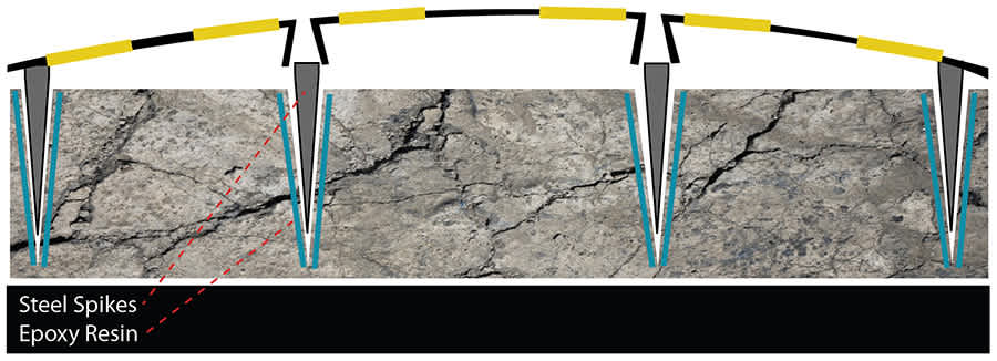

Before installing speed bumps, thorough preparation is essential. Begin by accurately measuring the area to determine the correct number and size of speed bumps needed, and plan for proper spacing between bumps, typically 2 to 4 feet apart depending on the types of vehicles using the road.1 It's crucial to obtain necessary permits and adhere to local regulations before proceeding with installation.
Gather all required tools and materials, including safety gear such as gloves, safety glasses, and high-visibility clothing. This preparatory phase ensures a smooth and compliant installation process, setting the foundation for effective traffic calming measures.

The installation process begins with digging a trench 8 inches deep and 3-4 inches wide where each speed bump will be placed, ensuring the surface is level to prevent shifting or breakage.1 A 3-4 inch layer of gravel is then poured into the trench and compacted firmly to create a stable foundation. Once prepared, the speed bumps are positioned in the trench, centered and leveled, with care taken to install them in high-traffic areas away from curves.1 The final step involves securing the bumps by filling the surrounding trench with asphalt or concrete, depending on the bump material, and smoothing the surface with a trowel for a seamless finish.1
