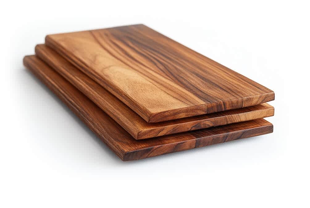

Manufacturing Process
The revolutionary transformation process begins with ordinary wood that undergoes a chemical treatment to partially remove lignin components from its cellular structure.12 This treated wood is then compressed, creating a dense material with enhanced strength properties through the formation of additional hydrogen bonds between cellulose molecules.3 Dr. Liangbing Hu, now a Distinguished University Professor at the University of Maryland, developed and patented this molecular-level transformation technique in 2018.45
Initially requiring more than a week to produce, Hu refined the manufacturing process to just a few hours, making commercial production viable.6 The technique essentially unlocks the incredible strength hidden in every tree, achieving 10-20x strength improvement by leveraging the natural properties of cellulose nanocrystals, which are stronger than carbon fiber.7 This process transforms ordinary basswood into the dark-colored "super wood" that maintains the natural grain patterns while delivering unprecedented structural performance.8

Superior Properties
Compared to traditional building materials, Superwood offers an exceptional combination of properties that make it a game-changing alternative. The engineered timber is six times lighter than steel while providing 50% more tensile strength12, making it ideal for applications where weight reduction is critical. Its durability extends to high resistance against fire (achieving a Class A fire rating), rot, pests, and extreme weather conditions3.
Beyond structural advantages, Superwood maintains the aesthetic appeal of natural wood, preserving the warmth, texture, and distinctive grain patterns that architects and designers value3. This combination of performance characteristics-strength, lightness, durability, and visual appeal-positions the material to potentially disrupt construction industries traditionally dominated by steel and concrete, while offering the added benefit of being 100% biodegradable at the end of its lifecycle2.

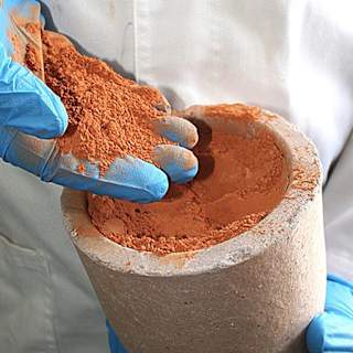

Australian clay breakthrough creates stronger, greener concrete
Engineers at RMIT University have developed a method to transform abundant low-grade clay into a cement substitute that produces stronger concrete while reducing carbon emissions, offering the construction industry a path away from its dependence on materials that contribute 8% of global greenhouse gas emissions. The breakthrough uses a co-calcination process that mixes low-grade illite clay...
