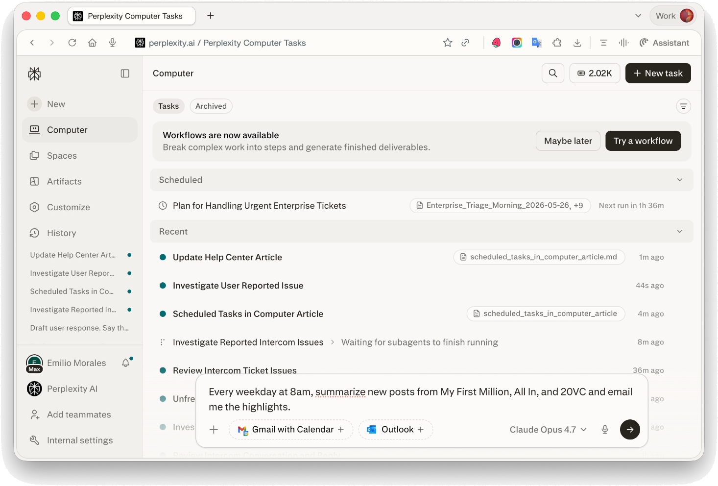

You don’t fill out a fixed form. You describe what you want in plain language inside Computer, and Computer proposes a schedule for your confirmation.
Open Automations from the left sidebar.
In the input box, describe the recurring task and the cadence. For example:
  • “Every weekday at 8am, summarize new posts from My First Million, All In, and 20VC and email me the highlights.”
  • “Check my Gmail every hour for replies from investors and notify me when one arrives.”
  • “Every Monday at 9am, pull the sales pipeline from Salesforce and post a summary to #revenue in Slack.”
Confirm the schedule and what the task will do. Computer reminds you that each run uses credits. Approve to create the task.
Your task now appears on the Automations dashboard, with the next run time shown.
The Automations dashboard with a recurring task described in the input box at the bottom, suggested automations above it, and Automations selected in the left sidebar
Figure 1 — Describing a recurring task in the Automations input box. You can also create an automation from inside any existing Computer conversation — ask Computer to “run this every morning” (or whatever cadence) and it schedules the recurring version of that work — or from the Create an automation box at the bottom of the Automations dashboard.
